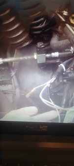

The manual says this wire is for shop tachometer.

This white wire

What 'white' wire is that? If it's a low tension wire, why are you asking about #1 plug lead? Mixed messages here.

Trying to find out if that wire needs a special shop tool to do rpm. The auto tach with the clamp is what I have attached to the plug wire and fluctuates.

'Shop tacho' is any tacho used in a workshop environment. It can be inductive or pulse, as long as it's not a dash tacho.. Dash tachos are inherently inaccurate. You can even use a non-contact tacho.
Find the 'shop tacho' you like and consult its instruction manual on how to hook it up.

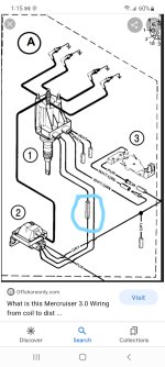

The manual says hook your meter up to this Gray wire on the bottom right hand side of this picture is what they do for a shot test but I need the plug that would go on there
