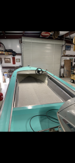

Update…
Down to windshield and hardware, foot steps on side rails and Bimini top. Looks good so far. Any tops on where to get the 4 windshield mounting hardware and the foot step rubber inserts would be appreciated.
