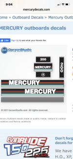

Those decals look 90s to me. Maybe the hood has been changed? These are 1982 decals.

The hood (minus the latches) and it's decals look like my '93 motor.
You look to be missing the lower cowling, which is what latches the hood.

Old motor with new cowling. Bungee cords aftermarket and proberly serve no purpose but for looks. Stock lower with homemade nosecone. Old racing trick on t-stat dual plumb as t-stats are replaced with washers

If that cowling is like what's on my '93, it is far from lightweight. It is solid fiberglass and 40# or so.

1990-91 had those stripes.

Thats not a lightweight cowl..it is stock. The liteweight cowl looks like below pic. You got a plain ole 150 or 175 2Liter with lipstick.....

those type cowls came out in '89... who ever did tha cowl bungies, vents, decals did a GOOD job!
