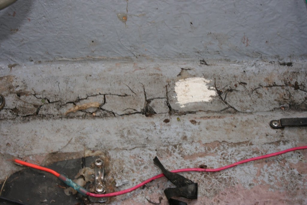

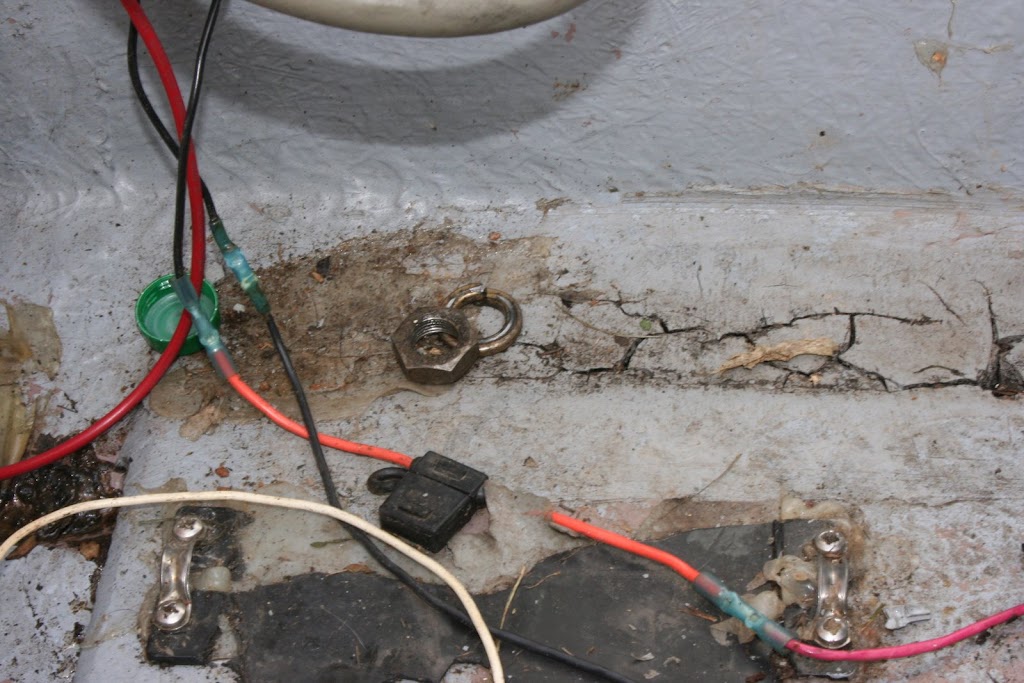

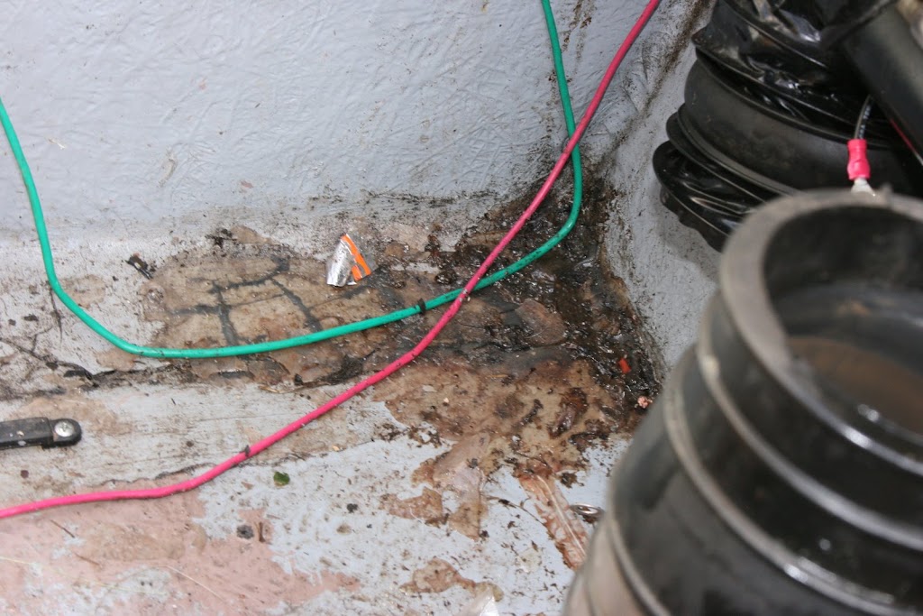

Regarding those cracks, most look to be in the original glass work. I see some half assed repairs, looks like they just poured resin on top of the cracks. You have two choices: Make the repairs fully assed by just pouring more resin on top, or do it right and grind away the cracked gel down to solid glass and add a layer or two of mat to replace what was ground away.

The engine is out to have the bilge repainted. I will grind out all the old stuff an lay fresh stuff.

That might be freeze damage, water seaps in and freezes, you end up with heaves. Looks like a simple fix.
