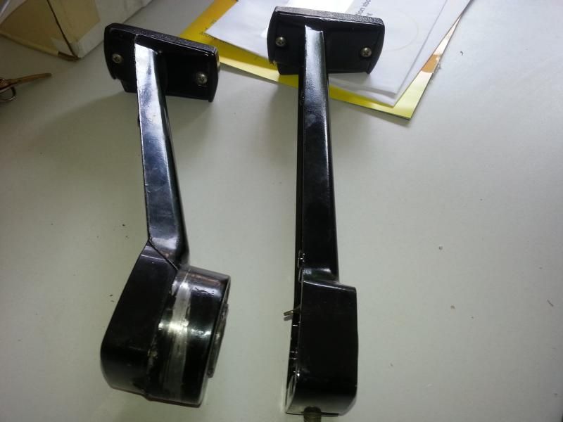

I am looking for a replacement handle for a Quicksilver circa 1987 Commander remote control box, side mounted, flush fit, with tilt /trim and trailer, and neutral lock. (OR REPLACEMENT UNIT original, modern, or non OEM)

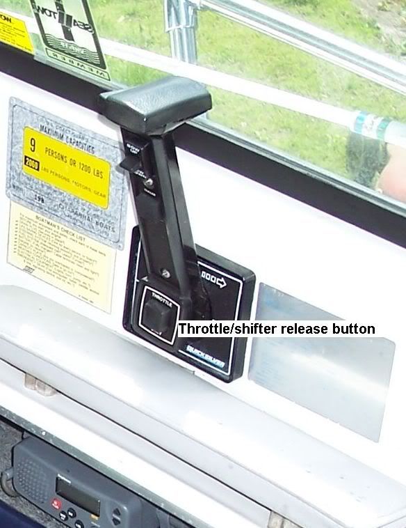

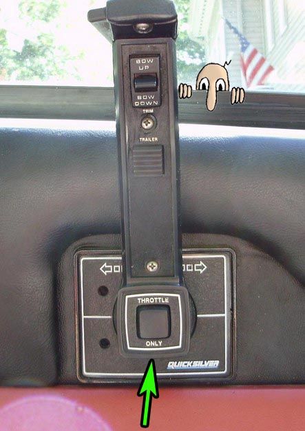

This is what the handle looks like mounted:
The handle differs from the Mercruiser parts list which is 93863A 3 Mercury Quicksilver Handle Assembly which has the internal mold number 93862 in that the flush fit model has a circular elbow joint / bushing as seen in the following pictures (left hand side unit) and is slightly shorter and offset.
The replacement handle I am after has the following mold number 87513
If the handle is unavailable I am happy to replace the entire unit with one that will be a best fit into the existing recess in the side panel (second of the mounted pics, mine has even more padding to the side pannel.

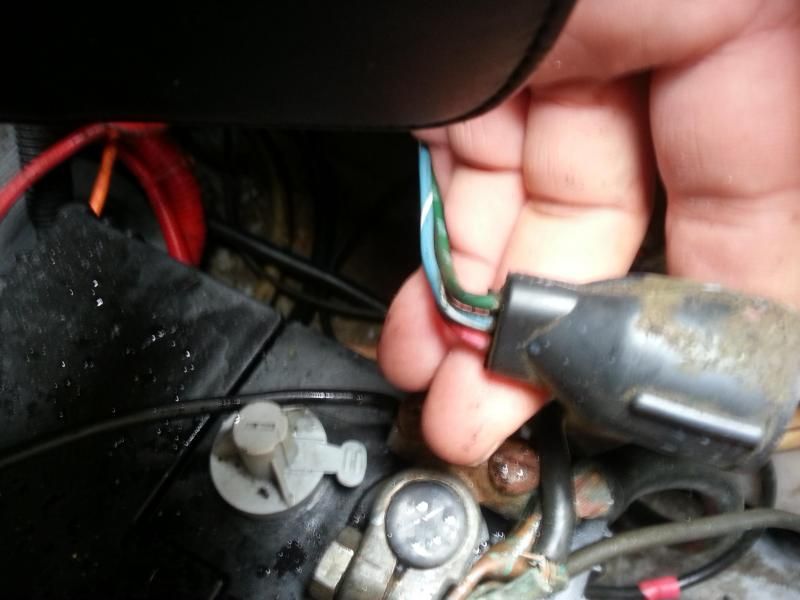

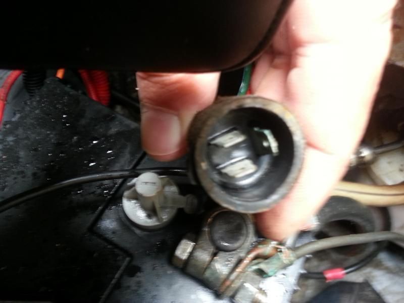

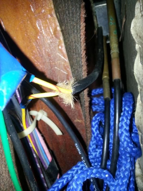

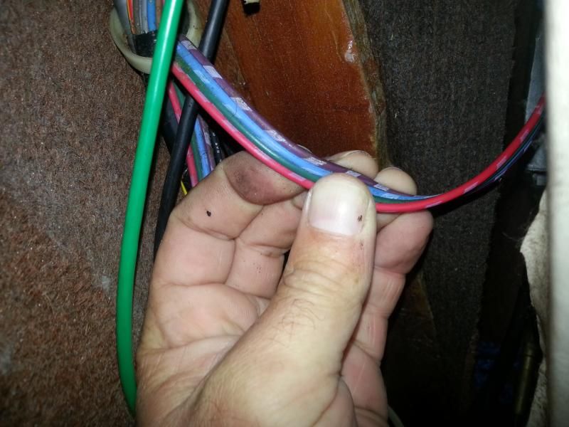

The control box has a 4 wire loom and a two wire loom that lead out of it. I believe that the two yellow wires are the neutral safety start / cut-out leads?
The four wire loom leads to the tilt trim motor where three go into the following plug and the fourth (purple) breaks off to the engine bay.

I have an 1989 Mercruiser Commander 2500 ...Only place is E-bay the handle itself you don't see that much but sometimes you can get the whole control for under $100.00. The wiring you stated is correct, there are two different handles one is straight up and the other is angled away.
