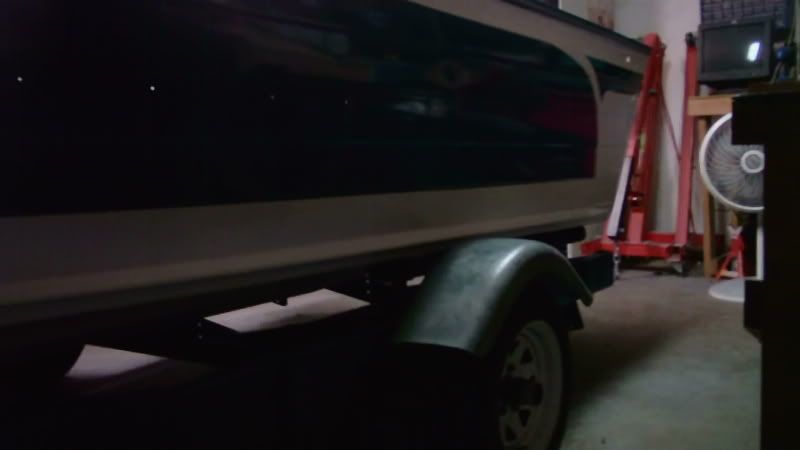

Ok so I just finished installing and adjusting the rollers. I positioned them outside the outer strakes. I wanted to being the boat as close as possible to the trailer. In order to do this i had to turn the roller brackets upside down. Now the boat is sitting 4" closer to the trailer and 2.5" away from the fenders.
before
after

Trailer setup looks good to me! That's going to be a really nice looking rig going down the highway. Did you paint the outside of the hull also? It really looks nice. It's so nice and shiny that a lot of us thought it was a nicely polished up fiberglass hull. Not trying to knock aluminum, just that a lot of them have telltale signs that they are aluminum. This one is just beautiful:D

Thanks Goziedt, yeah I painted it. It took alot prep though. But I finally got it, I just hope it lasts. It would be dreadful to see it peel off on my splash day. haha.
