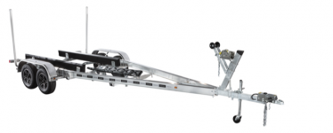

This is what the trailer looks like. It's just a stock pic. I can try to grab some actual pics of it once it stops pouring outside. 2 big bunks in the back and 2 smaller ones in the front. I didn't buy the trailer from a Marina..I got it from a trailer shop and unfortunately the boat is about 180 miles away. So I don't think they are setting up any thing lol. I have a call into the Marina that is working on the boat and eventually putting it on the trailer. The seller doesn't think it will be a big deal to them to adjust it as needed. So fingers crossed there

That trailer is quite generic and the odds are any v-shaped hull will fit fine without much adjustment, if any.
I did something similar when I bought my 24 foot boat. . . bought the boat in NJ and the trailer in MA. Then took the trailer to get the boat.
Just out of curiosity, I did take a few pieces of wood and made a frame that was the same shape as the V-hull (24˚ V in this case) to see if the keel would likely clear the cross members of the trailer. No problem . . . plenty of clearance.
Problems arise and custom fitting is needed when you combine multiple main bunks and keel rollers. Then everything has to be an exact match to the hull.
Trailer manufacturers have gotten wise over the years and realize that a simple trailer configuration will fit most boats with minor adjustments . . . usually being the front set of bunks.

I wonder will the OP be ok, given the his bunks are turned on end, if the bunks don't align with the stringers? Maybe I'm overthinking it.
Yes, over thinking . . . poerboats are not that flimsy
The bunks turned on end are common for many trailers as they require less mounting hardware to achieve adequate height above the cross members.
