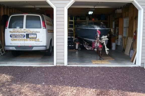

I have a 24x28, with a huge loft. Holds my Extended Chevy Van, 19 ft Chris Craft Super Sport, and there is a big work bench along with shelves. Everything fits, I can open the rear doors of the truck, and work at the work bench without moving the truck or opening the doors. I built the biggest I could. Recommend going with good concrete so the floor doesnt crack. They used a 3 inch slump and added Super plasticiser. Also, make sure you run cable tv to it, and a phone line. Important stuff!<br /><br />
