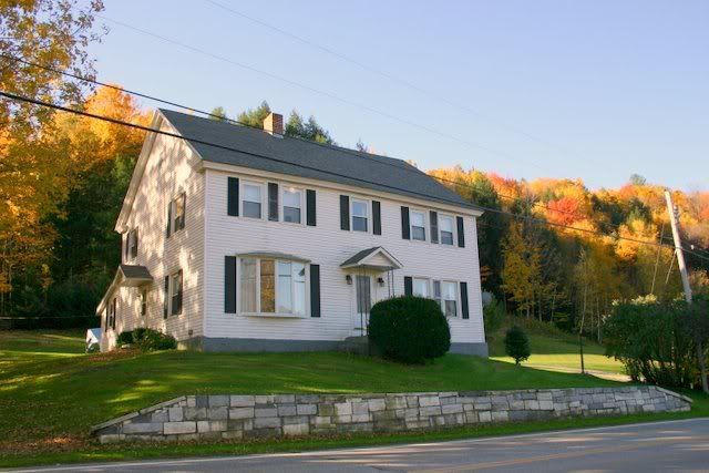

Nope a 2 1/2 story post and beam colonial yes with a stone foundation and dirt floor.......built a few years before the 20's and 30's closer to 1850-1860 ;) Oh and 12' high ceiling in the attic.
Older photo but the bulkhead entrance is on the other side.

When you mentioned the basement door being buried in by snow for so long, I had a quick flash back of my great uncles place, what I described was his place.
Kinda wondered how close I could come between the two houses. and his house was not colonial it was farm and us kids just loved playing in that big old house.
By the way nice house Bob but I bet painting it isn't alot of fun though, LOL.

vinyl sided :)

Nice place Bob, I used to hate siding colonials like yours. The way the ground falls away from the house it takes a 40' ladder and then some to get to the peak. I`ll bet the guy that finished the last few pieces of soffit and facias cheeks were puckered. :D
