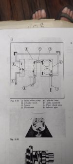

There are two circuits from the pump, the tell tail is simply a telltale. The other circuit is doing the actual cooling.. maybe this will help...

thanks flashback...that helps. the confusing part is that the thermostat seems to be housed moreso in the inlet manifold than the cylinder head.
and if I'm hearing you right, the telltale just indicates that the pump is working. it doesn't really participate in the cooling? it does get quite hot

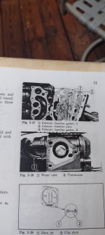

I can't see how the thermostat releases water to the exhaust.
it's housed mostly in the block, and partially in the inlet manifold
there's a water pathway to the thermostat on the block side. (see first pic).
If hot water from the block reaches the thermostat, it would open. But there's nowhere for the water to go. the inlet manifold side of the thermostat housing has no opening (see second pic) . Just nooks and crannies leading to dead ends.

You're lost me but maybe this will help you

If you look at the diagram I posted you will see the fresh water goes directly to the block and excess goes to the telltale.. when the water in the block reaches operating temperature the thermostat opens an allows the water into the head and then out the exhaust..
yes the first diagram made sense except the thermostat. it should be located on the left side of the cylinder head and it should extend into the inlet manifold. the
The intake is always cooled by the excess and that's good..

I think my engine is slightly different than the one in the diagram. 1)

That diagram came from an old factory manual I have lying around from 1979..
