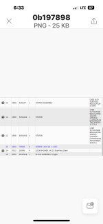

According to the manual they are not the same

it actually shows up as an '86... if there is no regulator yours is a nine amp... 5454 A7 is what you need.... if its a 5/8 you can run ANY 16 amp stator with or without a regulator... some say that you can't run tha 16 without a reg but with good battery program it won't hurt a thing.. if you have any electronics and/or use tha trim a lot it will keep any sign of over chargin' in check.. i ran 16's on everything i had/built from stock 150's ta hot rod 280's without a reg and never a problem....

tha lamination thickness is irrelevant to motor.. it is to flywheel.. ya need ANY 16 amp stator ta go with your flywheel.... tha normal stator used with tha 1/2 is justa 9 amp (really old) stator.. i don't remember any production V6 that came with a 9 amp after '85/'86.. maybe even earlier? below is a complete list of merc numbers you can use.. a lot of these are superceded numbers
