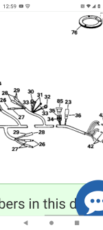

The pee hole where water comes out was barely squirting. I took a picture of the old before I took it off, this way I had a diagram ti go off of.

Pee hole could be plugged, doesn't mean it got hot. Starter button worked before? If so, wire or fuse most likely. Racerone wanted model number, maybe he's on to something. Post model number.
