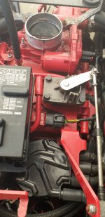

Alldodge, here is a photo of my TB with the flame arrestor removed.
I tested the high-pressure side of the fuel pump, on the fuel rail. I am only getting 20-22 PSI. I also tested the low-pressure side and that was about 18 PSI. I also notice the fuel pump is whining. I removed the pump and brought it home. I'll take it apart this weekend to see what the problem is.

Your low pressure is good, but high is low. The HP pump is most likely your problem. Could also be the fuel pressure regulator which is on the fuel rail (item 22 in above pic)
The pic of the TB means you have a drive by wire control. Sure could use a serial number but we are getting closer
