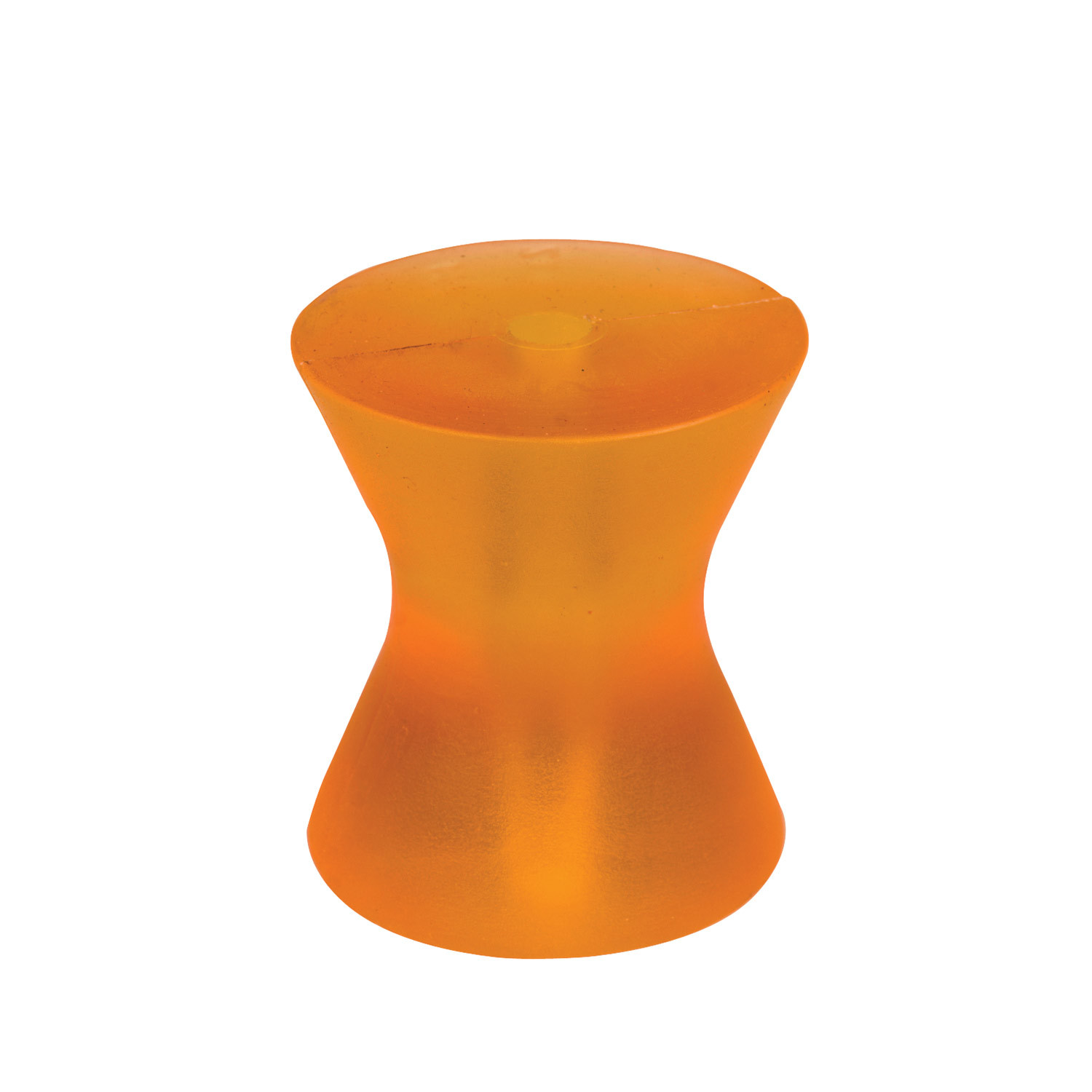

Now to figure out a bow roller. I can’t seem to find anything that fits very well. I have black rubber and a poly setup on hand. The black rubber with small end bells probably fits best but have heard they might leave black streaks. The poly one with tapered bells isn’t really close at all. Honestly I considered putting 2 end bells with a spacer in the middle. That seems fit the angle of the bow the best.

The roller position in the first picture looks good. But, I see what you mean with the bow roller not matching the V shape of the hull. Is that a 3" or 4" wide roller? It looks like 3" from the picture, but I could be wrong.
If it's 3", have you tried something like this that has not so much of a deep V shape to it?

It is 3" roller. I havent tried that one yet, I picked up a few different ones locally and none seem to really fit that well. I have a couple more coming tomorrow that I came across on Amazon and will see about those.

I found a roller on Amazon from Tiedown engineering that seems to fit pretty well compared to the others I picked up. I did notice it is considerably more pliable that the others which helps, or is that a bad thing. I would say its closer to the black rubber that the other yellow rollers I tried. It helps form to the bow a little better but I dont know if it will hold up or just deform once and be done. For reference the one I took off was a blue hard plastic. It worked ok but once deformed it cracked and held that shape.

No requirement that the bow stop has to match the hull shape, just personal preference only.

Other than a little jetski or an old woodie, I haven't cranked a boat winch in years. My current two boats had the winches removed and the winch stands modified to accept a Powerwinch. In both cases I used a poly roller setup because of their non-marking qualities as well as their long service life.
One boat has a pointed stem, the other rounded. The rollers work well in both cases.
