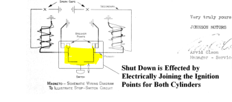

killing the motor involves shorting the 2 M wires if the switch is a problem you can rig up any normally open push switch and kill the engine by pushing it
