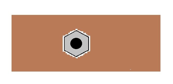

You could use those but just as easy to use the nuts themselves...something like this...
Just drill a hole about the size of the nut then use a chisel to square it out a bit then epoxy the nut in. JBC's pics are exactly what I was thinking of for motor mounts to accommodate this type of system.
