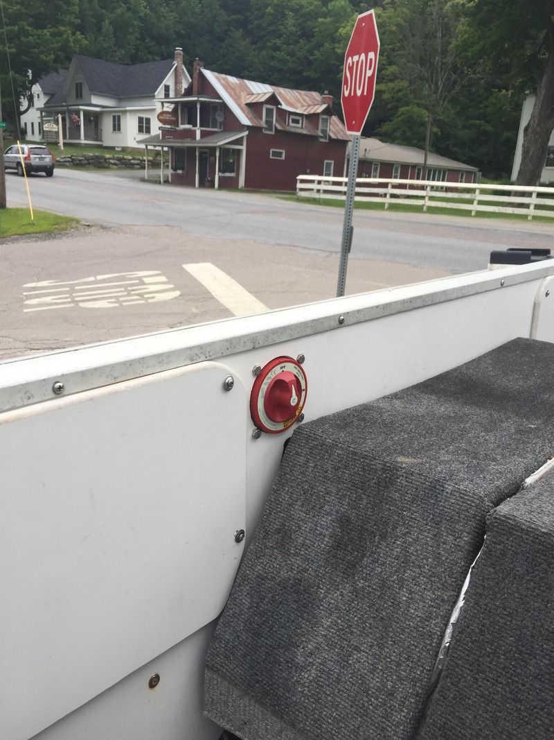

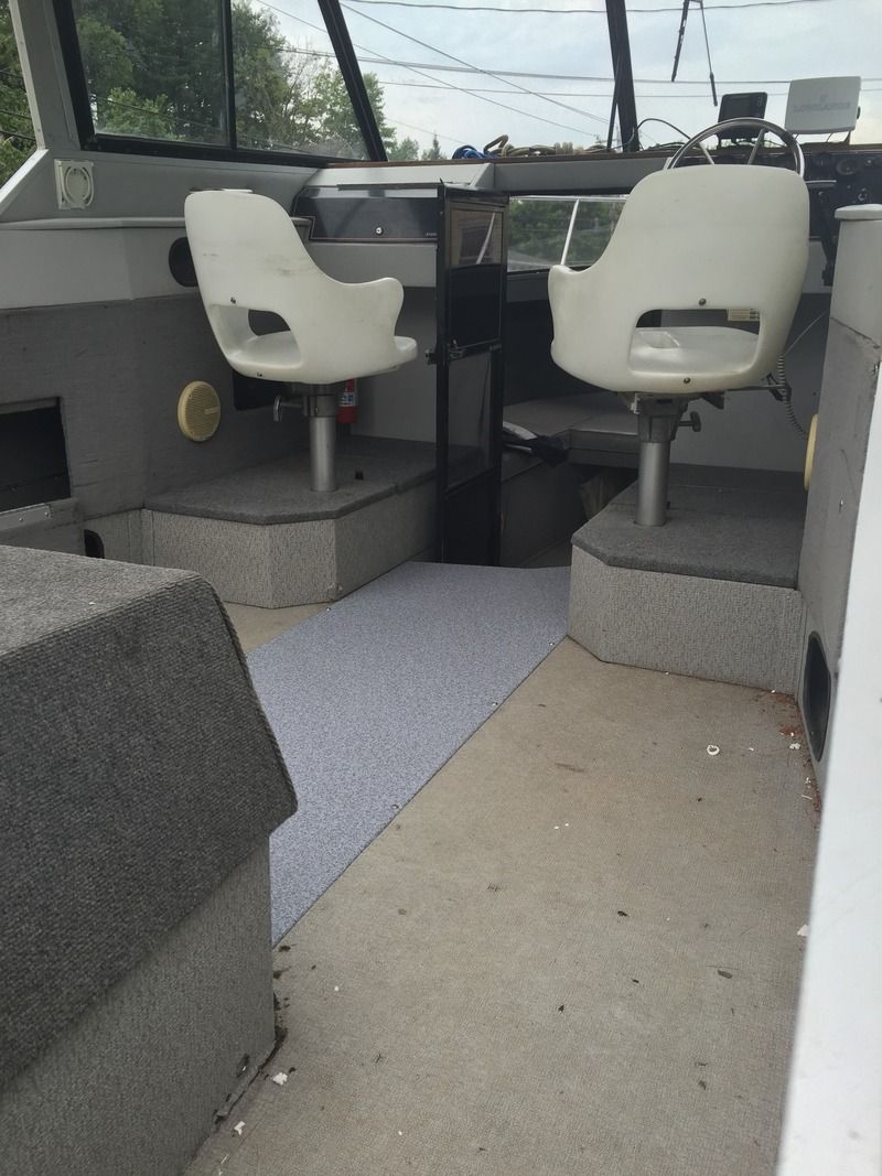

Vinyl is finally on... and making the rest of the floor look REALLY old. And boy do I need to vacuum this sucker. What are all the little white things you ask?
The result of adding this little guy in. The new switch is way easier to get to than the old one that sat behind those screwed on panels. Time for 9 days of camping on the lake! I think she's ready.
