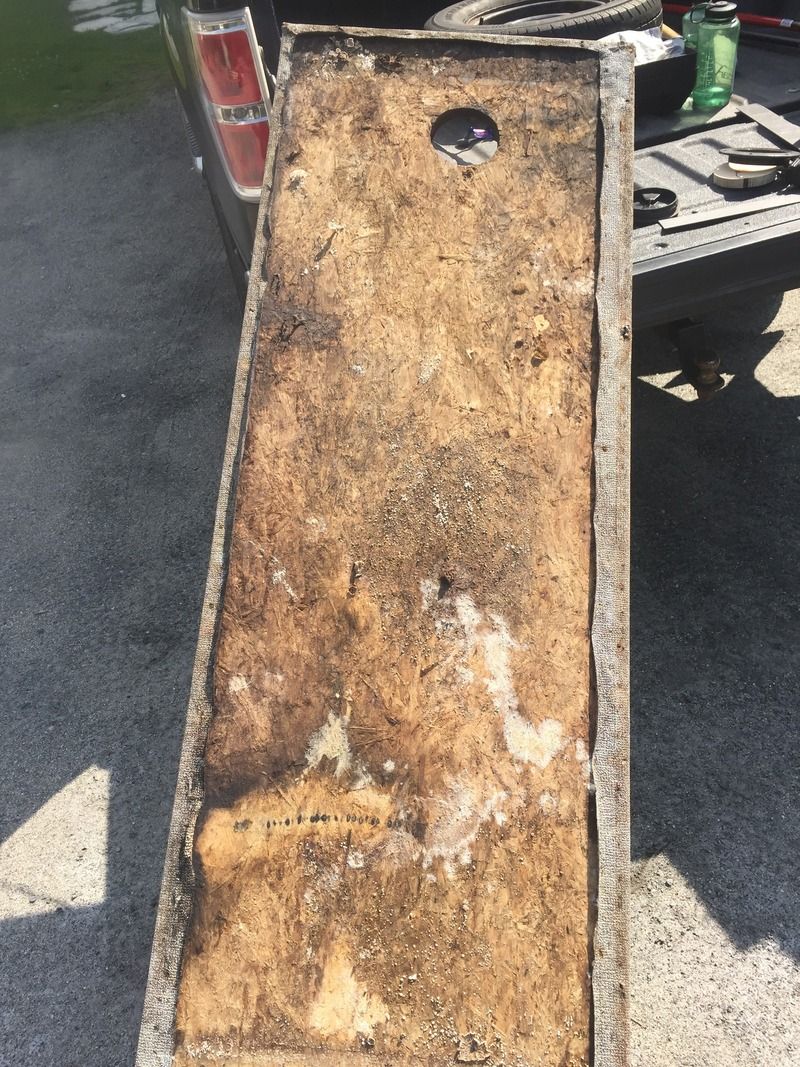

Pulled the center piece of the deck up. The wood is pretty beaten up, but didn't fall apart. The good part is it appears the foam surrounding the fuel tank feels dry. I'm hoping that is reflective of the rest of the foam. I need to do a good ole cleaning in here before I lay down the new wood.

Oh yeah I would say she's in need of a new deck. Water rotted the deck out and gravity pretty much dictates where water will go. So the only way to know for sure is to take a core sample from the thick section of foam as the outside will always seem dry to the touch. Man the top of that fuel tank looks nasty, what was on it?

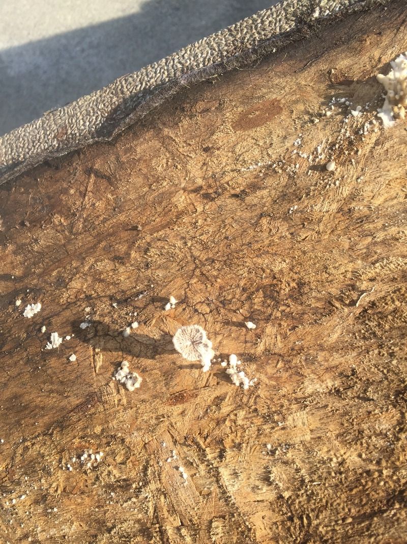

Just straight to the plywood deck. It's loaded with mold, and the deck had some interesting mushrooms and other fungi growing on it. I'm thinking just some rags and soapy water on top of the tank, not wanting to do anything more aggressive. This plywood just had vinyl directly stapled to it. I'm thinking it wise to coat the wood in either some West System or varnish. Any suggestions?

if that was me and I saw that on top of my tank I would probably accept the fact I would want to see what else is under that deck.but that is just me if I clean the top of that tank and put the deck back down, the back of my mind would be rolling with what else is under there

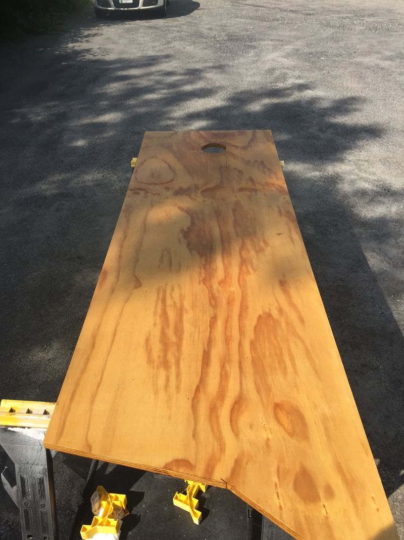

The 'old' wasn't original either, some knuckle head used OSB. :nono:
That right there is some fine looking ply you got, nice 7 layer 3/4" with no voids! It even sounds different when the saw blade hits it. :thumb:
flyingcow
Seaman Apprentice
May 7, 2015
36

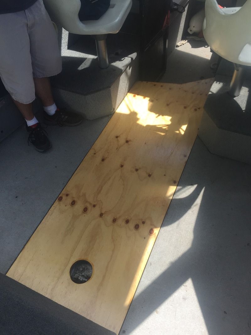

It isn't perfect (ACX), but even the C side is nice and smooth. The saw cut through it like it was nothing. It was Wonderful!
Only the center piece is OSB. The two side pieces are original ply that also need some love, but weren't nearly as bad as the center section.
g0nef1sshn
Lieutenant
Feb 24, 2015
1,291
Nice cut! Id seal and soak them knots up good with what you go with as a sealer. I would have tried to put that side down. But your going vinyl so I doubt water should be able to get them and soak into them anyhow. Nice fit! Measure twice and cut once! Im still messing that up a little as i go.
flyingcow
Seaman Apprentice
May 7, 2015
36
That's got two coats of spar varnish on it. I decided to put the A side down since it won't be covered with vinyl. I can't wait to do the other two pieces and get a rock solid deck!

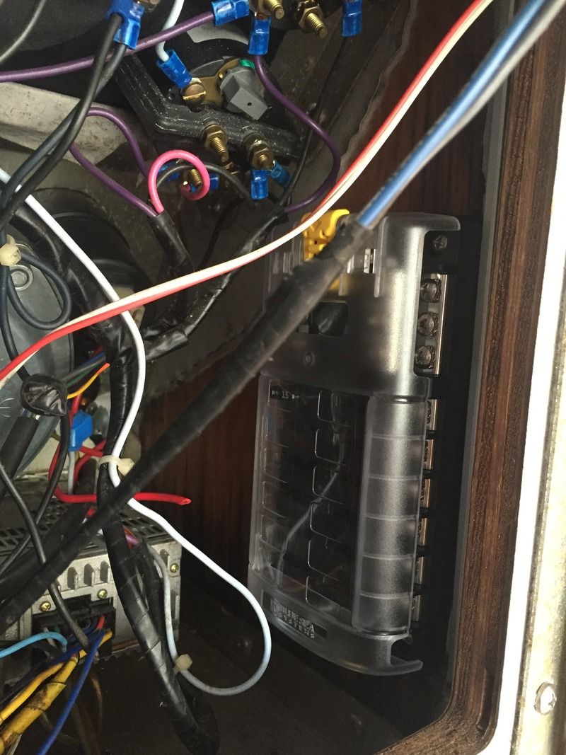

This weekend was electrical time. We dove in to understand how the boat was wired, and made some changes to make sure off means off.

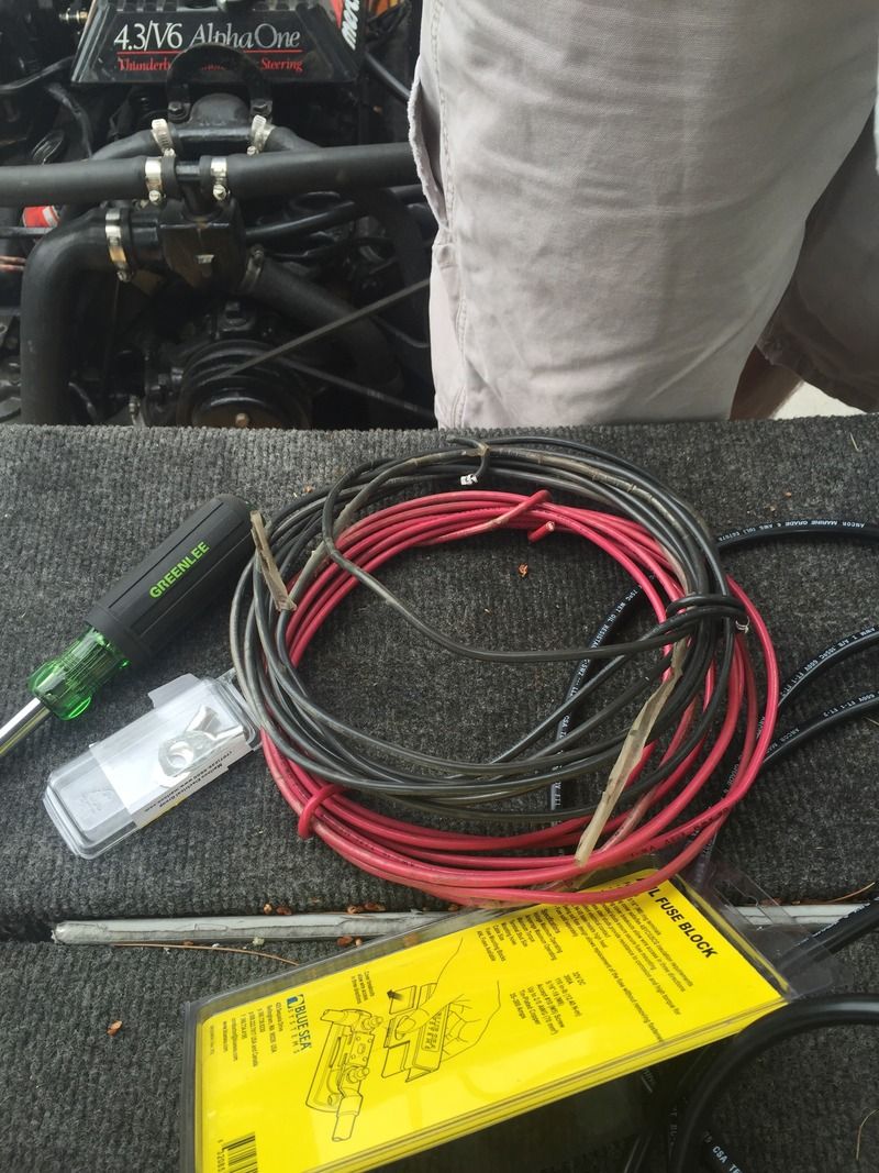

A Blue Sea fuse panel went into the rats nest and now powers the GPS, Sonar, and cabin lighting. When I finish, it will also power the navigation lights, blower, horn, and any other house load. The fuse panel is switched from a new DPDT switch and ACR between the start and house batteries. The bilge will bypass the switch so I can turn off the rest of the power when the boat's in the water.
We also pulled out about 30 feet of wire.
Most of it was good wire. Some of it was two pieces of wire spun together under electrical tape and some speaker wire providing 12 V power. I'm glad we did this project!

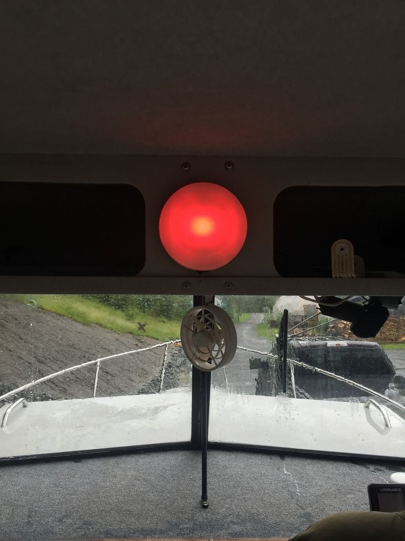

In the mix of this new wiring architecture, we took some of the leftover wiring and got the helm light working again! IT HAS BATTLE MODE!
...aka HAL 9000 mode.

Love the battle mode! I thought Id see speakers once I saw the speaker wire.
