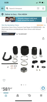

off topic question, is this a good quality transom kit for the bravo 3 out drive?

8M0095485​
This is the full kit which includes the exhaust bellows. May want a exhaust tube 78458A1 with the B3. Or can pic a choose parts as Scott mentioned

Lol I punch that part number into Amazon and I get prices from $50 all the way up to 400

Yes but read the fine print. The ones that are real low are aftermarket
400 is the oem 50 is aftermarket junk cross referencing the OEM part number
Or just buy from mercruiser parts .com or marine engine vs amazon

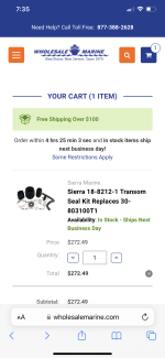

I've still had fine luck with Sierra parts 🤷
Every once in awhile they try to sneak in one of those green paper gaskets, but I'm running on my 4th season of Sierra bellows, and several seasons of the shift cable (which had a plastic coating as well). Also, just replaced an impeller that was on its third season and looked brand new as well.

I got this when I punch it into Amazon, is this oem?
