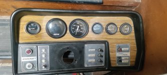

I have a complete gauge set that was to go in my Sunray restoration. The gauges are Faria Euro design. Totally different from the 5-inch Newport gauges in the boat now.
Now is there a big difference between performance from the GPS and pitot tube speedos ? I will have to change all my gauges, so deciding if it is worth the effort as, if it ain't broke don't mess with it, keeps popping in my thoughts on this one.

Thank you all for the advice.....The Newport GPS speedo is discontinued for my boat. I looked at the connections of my gauges and they are all proprietary. As in plug in, not studded. So I am on the hunt for a 5 inch GPS that will blend in. The Kronus looks to be close.
