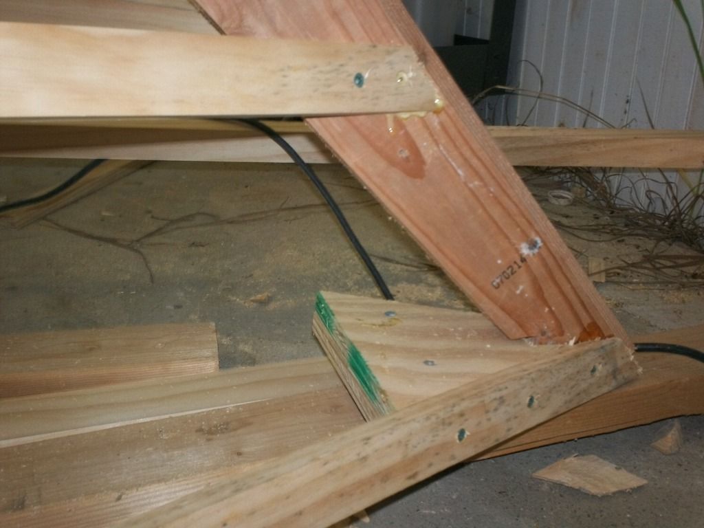

So I glued and screwed the lower battens at the stem......and readied the mid and upper battens, leaving the stem connections to last.
I used Gorilla Glue for these connections due to ease of use...
