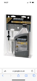

Go to would be the usual quicksilver gear oil. You’ll need a litre bottle of it and the wee pump it can come with as an option. You’ll also need two of the fibre seal washers for the drain and vent points. No need for the high performance stuff on that engine, but there isn’t much price difference to be honest
