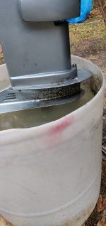

I have just bought 1984 16' Jon Boat with 1984 Evinrude 35 hp. i have the engine in test barrel. Before ever cranking it I replaced the water pump and gear oil (pennzoil 80-90W marine gear oil) after running it at no more than high idle for 10-15 min I will start getting a good bit of green looks like gear oil in the water and all over the first 2" of the lower unit and coming out water drainage hole on side. When I took the drive off the inside of the drive was coated. My thought was bad drive shaft seal, but there was no sign of oil inside the pump area???? and there is no oil
showing in the prop area or coming out two exhaust holes on upper exhaust housing. I made up
diy pressure tester and pressured the drive to 10# and put it under water no bubbles-no oil. HELP

This is alot of oil, engine is running well.I don't think I put this much oil in the 4 gallons I mixed 50-1. This is not just a film, there are 2-3" blobs.

sending photo, hope this is normal

Actually, Capt, I consider that to be pretty darn clean for a 35hp running 15 mins in such a small barrel. You should see what a 1960's motor would do in there, before EPA started cracking down in late '60s. BTW, I run a 1984 35hp on my own personal boat. I consider it the best motor I've ever owned.
Allow me to explain a bit more. Every drop of oil you put in the fuel tank passes through the engine. First it goes through the crankcase, where it lubricates all the bearings and piston skirts. Then it enters the cylinders where some of it burns (and makes smoke, which people also fuss about). Then, what's left after that goes out the exhaust, where it picks up particles of carbon, creating the black stuff in your picture. On the way out the exhaust, it mixes with the cooling water, creating the other emulsion you are looking at. All this is made worse because you are running at slow speed in neutral, in a barrel, and the motor never really gets warm enough to burn much of it off.
As I said, get it out of that barrel and onto a boat, on the lake, and you should be happy with it.
I apologize if I offended you with my earlier remarks.

Water level in that test bucket needs to be 10 " higher.------Pump impeller must submerged to work properly.
