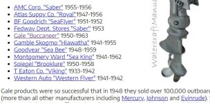

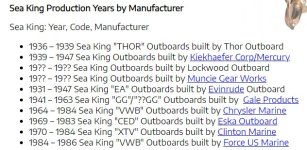

Sorry, gotta disagree.. No 7.5hp Gale motors ever. Buccaneer or otherwise. Might have been an Evinrudé, Chrysler or Cinton or ? Produced motor. Post pictures and w÷ can identify.
__
TN-25
May 27, 2008
626
Montgomery Ward used Chrysler outboards once Gale / Buccaneer pulled the plug.
Did they ever use Eska outboard in the 1970s?
