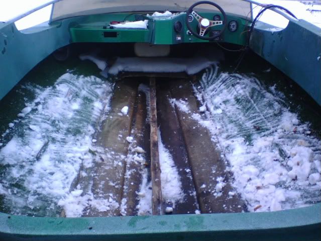

I found this old rotted out 15' something on craig's list. She has all the normal rot deck, transom, stringers, any thing made of wood. With a bonus of the glass being cracked on the out side of transom.
Any one have any idea of make,model or year not that it matters but would be nice to know.
She has a cool look well i think so anyway.
Was thinking about using the eng and jet from an older jet ski for power. Have seen this done on john boats but never anything like this.
I would think 50hp or so would make this thing go just about as fast i would want to go in it.
Any thoughts

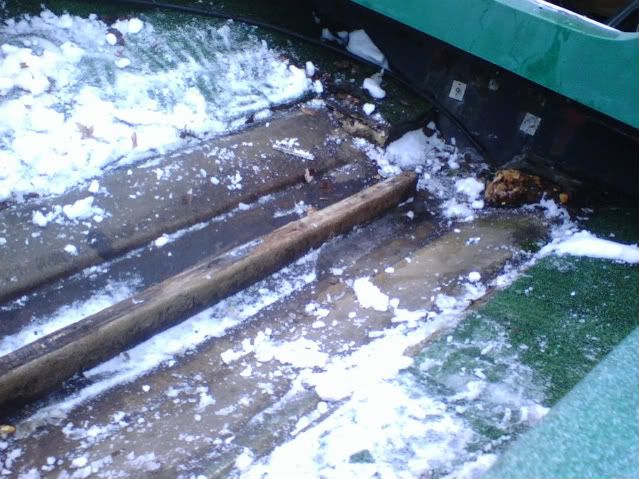

Thanks for the info and oh yea the rebuild has already started well the tear down part anyway.
Someone has already taken most of the deck and foam out(thank god) as far as I can tell they did a good job of it.
The stringer is a hollow shell of its former self.
Transom is mush in the shape of plywood but that was expected.
I hope to get here in side and have the cap off in the next few days. Dang X-mas getting in the way of my boat tinker'n again

I may be able to get the transom done but the deck and stringer under the bow needs replaced. I nearly killed my self working under the bow on my century and this one is much smaller.
My rub rail is in bad shape. I think mine is aluminum so it should be easier than yours was to fix.
How is that seacast working out. I am thinking of using it for the stringer.

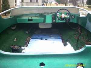

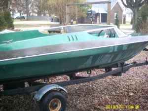

32_d3gr33s
Petty Officer 3rd Class
Sep 4, 2010
89
Bondo
Apr 17, 2002
71,516
Re: Future Hot Rod
Ayuh,... Nice boat 32_d3gr33s,....
Now, could you resize, 'n re-edit your pictures to 480x640,..??

Re: Future Hot Rod
Thanks again arc I am still doing some research on the jet.
That looks just like it 32_d3gr33s.
