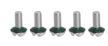

Turns out that the replacement bolts were just a hair too long for my threaded inserts. I was able to snug them all down and it "felt" snug (w/ zero movement between plate/rubber gasket/tank), but with a full tank, there was a tiny amount of seepage. I added a washer to each bolt and did a test run, and it's dry as a bone... no sealant required.
