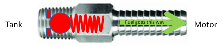

With it running for short time and still nothing being pumped, check your antisiphon valve on the tank, fuel line and filter to make sure it's not clogged
