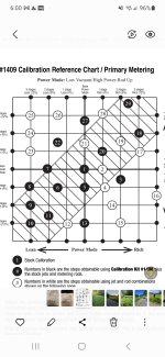

I just read the Bible and the chart that came with my calibration kit 1488 is different. Here's a pic of what I got
What difference are you seeing? the book will have more combos then the kit.
I believe the kit is just a portion of what rod and jet combos are available. I ended up buying individual rods as I went.

Here is the two sheets
