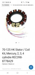

As i can see on Ebay should this be the correct stator:
8778A29​
But i see 6 wires instead of 4...
pnwboat
Oct 8, 2007
4,251
Yes that is the correct one. If I remember correctly, the installation instructions for this particular stator on the CDI WEB site says to run the Red/White and Blue/White wires to engine ground. The original stator had the windings internally wired to ground. I think I saw a used one on Ebay for less than $50. But you're taking a chance.
I think you can test to see if your Switch Box is good using the stator that you have right now. Run one of the stator wires to the candy bar, and attach the blue wire from the candy bar to the Switch Box like you have it now, and the other stator wire to engine ground. Doesn't matter which stator wire. There is no polarity. The stator that you have has the same voltage output and resistance as the original stator's low speed winding. Crank the motor over and see if you get spark. If not, disconnect the Black/Yellow wire from the Switch Box. This is the ignition Kill circuit. By disconnecting it, you are disabling it. Check for spark again, If no spark, then you may have a bad Switch Box.
