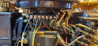

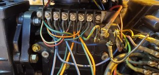

I replaced my 507X5A with this 507X8B that I bought used out of ebay. I wired it up per the colors but I wonder if something is different at the switch than my old motor. Two issues now: 1) Coils smoked badly and smell of smoke. 2) Motor started right up but would not shut down with the switch. Had only run for a few seconds so it died when I idled it down. This used motor was available because it slowed down after running at WOT for a short time. Said to maybe be a feul issue so didn't seem to be to big a problem.
So now what? Is this something with the wiring or was the original problem a coil issue? Both coils are distorted, one has fluid leaking out. To start, can anyone give me a listing of what I should expect to have with a test light or volt meter at each pin of terminal strip with key on and key off? Other suggestions? Guessing I'm going to need coils regardless, hopefully I haven't wrecked anything else. Compression is 118 PSI.

The 507X5A is a 1985 year model with battery ignition, the 507X8B is a 1988 with CDI ignition.
The battery ignition is feed by the battery, the CDI ignition is self energizing from magnets in the flywheel.
Your CDI system was only used in 1 or 2 years then there was a Prestolite CDI system on the 50Hp:s I believe.
I do not know where you can find a electrical diagram online, maybe some other jerryjerry or The Force etc will cime in and post a diagram.
However the different between battery system and CDI is that the blue wire and white wire are connected different.
Battery system
Blue......connected to I terminal at keyswitch and blue (ignition) at terminal strip at engine.
White......Not in use.
CDI system
Blue..... connected to M terminal at keyswitch and at blue terminal at engine. Then the blue terminal is grounded at engine.
White.......connected to M terminal (the other one, there are two at the switch) at keyswitch. and white terminal at engine.
This white then goes to the CDI module.
The big different in those two systems is that the battery system need 12VDC to operate and you stop the engine by shutting off the 12VDC voltage.
The CDI system is self energizing and it does not need 12VDC to operate. You stop the engine by grounding out the CDI module.

I think they are fried as you got 12VDC voltage at the stop circuit.
My experience from CDI systems that got power at the stop circuit is that they usually went bad.
But wire it up correct and give it a try, you have nothing to lose.

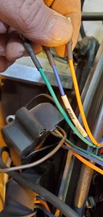

The wires on the new unit, Brown is not showing

I have looked at it closer and it seams like you have wired it correct.
So some questions then.
The brown wire at the new CDI box, where have you connect it and does the new CDI box have any black wire?
From the diagram in #4 by The Force the CDI box should have a ground wire (black) and the brown wire should be connected at the terminal for the harness to blue/black or blue. Maybe the new CDI box does not have a good grounding.
If you do not get any improvement I would suggest you to contact CDI Electronics and speak to a technician.
The new CDI box might be bad as it do not produce spark at cylinder #1 when you swap with that one.
The trigger signal for #2 cylinder seams to be okey as it produce spark with #1 CDI box when swapped.
