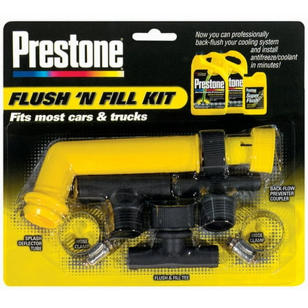

For a stringer you dont have to use the or get the flushing kit that is made for the trunion caps , it certianly works .
As an alternative though you can just grab one of these at any parts store for 5 bucks , you install that "T" piece on the hose coming from the internediate to the Tstat housing , and youre done .
