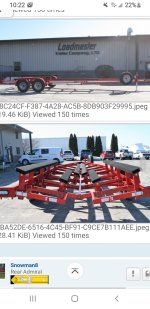

check this pic to see how custom cobalt trailers extend the outer bunks.

84Ed
Seaman Apprentice
Jul 3, 2005
32
Maybe cobalt can tell me what weight the end of the outer bunks carry.
thanks for the help !
jimmbo
May 24, 2004
14,702
Ask Cobalt who makes a Trailer specific for your hull, and contact info
