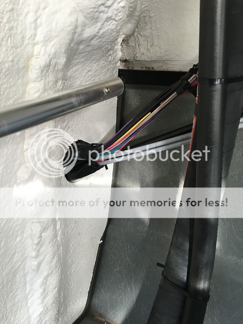

I'm installing a fishfinder/depthfinder which is transom mounted.
I'm hoping to chase the cabling through with the other cables from the engine compartment
From here
To here at the helm
Are there any tricks to making this easier as it looks pretty tight

Fish tape can be purchased in the electrical dept of any home store. You'll need to open the boot and then run the fish tape from the helm to the stern. Attach the cable and pull it back. DO NOT pull only on the cable connector. Tape the connector and cable securely to the fish tape. Taper the area in front of the plug so the plug itself doesn't snag during the pull. You might also coat the cable with a pulling gel (also available in the electrical dept) to help the cable slide in what appears to be a pretty full chase.

I had another look at where the wires go in, there's a rubber boot around the cables crimping them together, I removed it and had a feel around inside the cavity, it seems to just be a void as in no 'tube' to run the wires through, my concern would be if i pushed any fish wire in through the hole it'd just get lost in the cavity and be impossible to get it to the other opening as it doesn't have a tube to run through, would this happen ?

Okay, wait a second, you still can run your cable with the rest of the wires. Remove one wire that is going to the helm area or where ever you want the new cable to go, and tie a string onto it. Now pull that wire back to the boot area. Then attach your new cable to the wire and string and pull it back to the front. Bingo, new wire run with the rest of them. JMHO

Id thought about the option of detaching an existing cable but they're all pretty tightly bundled and cable tied together
In the end I bought 3 threaded rods and coupling nuts, passed one bar in, attached another and so on with a fishing line taped to the front.
The good lady was happy to get under the dash and poke her finger through the hole and it actually worked.
