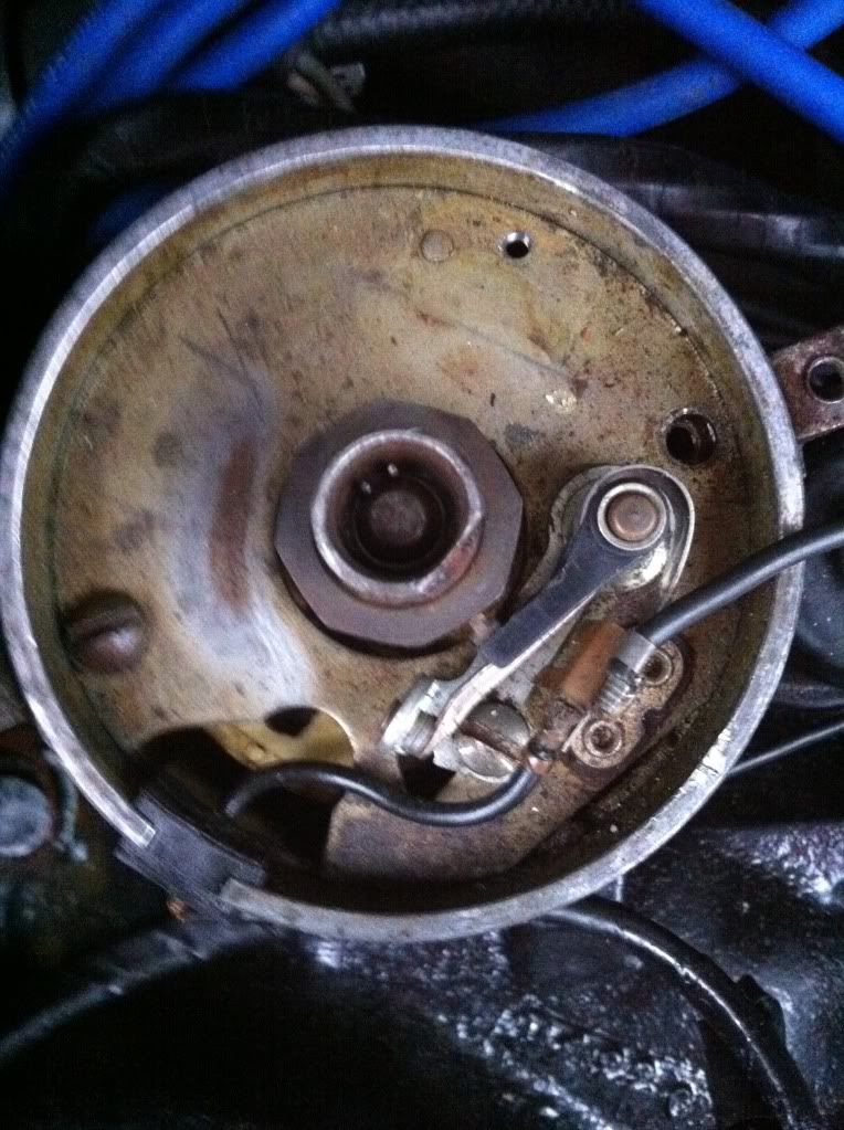

Pic of my dist. I already took the condenser out.

As far as your dist settings, dwell affects timing so if you change dwell you will change the timing, that's why you set dwell first then the timing. You did set the points with the rubbing block on one of the high points of the dist cam right? You are also supposed to put some cam grease on the dist cam (you can use trailer wheel bearing grease but not too much). Also you can put a drop or two of oil in the dist shaft (there is a foam pad in there) to oil the advance mechanism.
Thanks, Yes I knew the dwell would effect timing but I didnt know it would be that much. I did see the old points were nearly closed when they were supposed to be open.
Yes I was checking the gap when the cam was on a high spot. (ie when the cam pushes the points open). And yes I did put some cam grease on it.
So the mechanical advance is under the plate that the points and condenser sit on?
I will look for your other post and then see what the advance is when I go to the boat later.

Remove the screws holding the braker plate and take it off and you'll see the advance springs and reluctor arm, grab the end of the shaft and advance by hand with a twisting motion and you'll see the workings, there sure could be something amiss with the advance springs, my expereience has been that dwell doesn't effect the timing that much.
