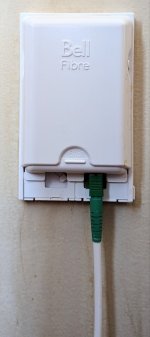

Finally remembered to get back with info on this.
Install went well. Took about 1.5 hours.
Guy ran a fibre cable from the pole in my lane to the house and terminated it in a wall mount box.
The SC/APC connector ends for the fibre extension cable that runs from the termination box to the modem are 9mm or .354" wide.
I had pre-drilled 1/4 holes where I wanted the cable to run so used a 13/32" bit for the final size.
Here's some pictures.
