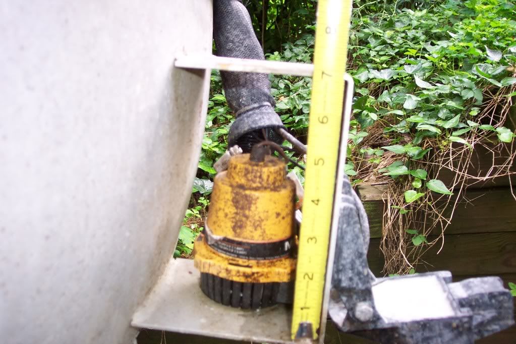

This was pictures of my "dead" ( seized ) pump that was replaced. There is wire mesh that fits on the sides to help keep debris out.

This is my bracket and pump setup. Pump says 500 GPH but it's a 750. This pump has replacable cartridges. I deceided I needed more than 500 after I bought the new pump so I picked up the 750 cartridge and will save the 500 for a backup. My son-in-law is doing the same think you are. He didn't have the bracket/box on the back of his toon so he looked at mine and the last time I talked to him he said he'd found a guy at a boat dealer near his lake place who puts them on all the time. He said he'll have one welded on as soon as he can get the time. Didn't ask how much it was going to cost him but I don't think it was much.

Thats how that pump goes in there. I've been beating my brain on what type of pump and how it would mount. Guess you just run the hose to the livewell then huh? I was gonna take a storage type box that will fit into my seats, add a drain in the center and run a hose up on the side, didnt know what kinda pump i needed. That pic helps a ton.
