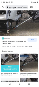

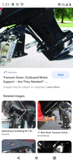

Not sure anyone is going to sign off on that but it seems fine if not traveling far. Here is what people are talking about, transom saver and motor extension lock I believe like racer said.
