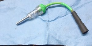

Rjybilcom
Jul 31, 2022
61
Jimmbo, looking at this tester, it looks like the gap in it is 3/8.
Honorary Supreme Mariner
40,013
Glue 2 wires onto a piece of cardboard / plywood.----Space them 5/16" apart.-----Does spark jump the gap , yes or no ?
