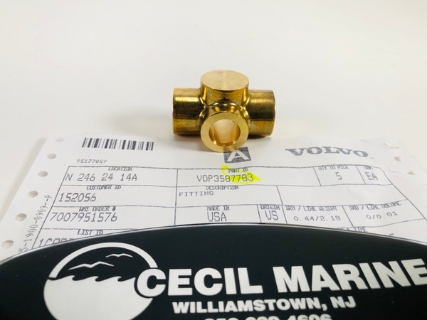

Looking at the design of your oil dipstick to oil pan configuration, one thought could be how was the condition of the old oil from the first oil change and even if it was ok (not milky), did the old oil get stuck within the fitting flow characteristics and then become temperature related to eventually cause condensation 'plus be blocked (or trapped) by the fitting holes of the brass fitting and retainer too not letting you get a good oil level reading sometime later on of time 'until you cleared it again with sucking out / moving the trapped oil.
looking at the parts catalog, the dipstick doesn't go directly into the oil pan, the oil has to flow down to the fitting and fill the fitting and the oil tube to get a reading... And the fitting/bolt retainer has its own little hole the oil has to flow through as you'll see looking up the part numbers linked below with photos of the components holding it all together.

Fun Times' explanation makes sense because this dipstick design is attached to the oil pan at the bottom of the pan, so for the oil to read on the dipstick it has to travel up in the tube (as you fill the pan with oil) until the level in the tube equalizes with the level of oil in the pan. If there is any sludge in the tube or fitting that screws into the oil pan, it is certainly possible that the pan can be full but the oil can't rise up to the proper level in the dipstick tube.
