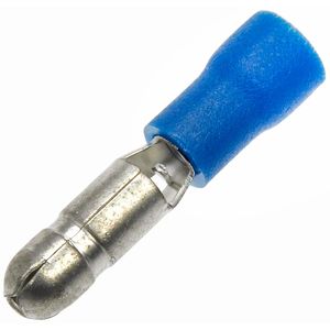

Okay, I have to say I like your enthusiasm for sure. So lets walk through this a little. First off, I have zero idea how your boat is presently wired. So with that stated, lets go over a typical setup. Usually how most boats are wires is, they take wires (usually about 10gauge) from the battery and run both a positive and ground wires to the helm. The positive wire has a fuse or circuit break at the battery to protect for shorts to the helm. That is very important to understand. At the helm (control area of your choice) you install a positive AND negative buss block. What that is a basically a block where all the connectors are strapped together to allow different circuits to branch out from. Then each individual circuit from that buss block goes through either a fuse or circuit breaker sized according to the amount of amps that circuit will need. Hence, bilge pump, 5 amp fuse. So you wire off the positive buss block thorough a fuse (or breaker, your choice) and then maybe even a switch if you want to control that circuit. From that switch you run a wire to the pump. And the ground wire at the pump goes back to the negative buss block at the helm again. That completes one circuit in your boat. AS for what type connector you use is totally depended on the buss block type connectors. For instance, if you buss block uses screws for the connections, then you use crimp on wire connectors the size of the screw diameter. If the screw is a number 8 screw then you use number eight holed connectors for that ends of the wire. But you also need to know the gauge of the wire to buy the proper connector. If you are using 16 gauge wire to the pump (a typical gauge used in a lot of boats) then you buy connectors for 16 gauge wire. On the switch, they usually use push on wire connections (spade connector). So you again buy the proper gauge wire spade type connectors for that switch. At the pump itself, you can either lap solder the joint or use standard bullet type wire connectors. But again you buy the proper wire gauge bullet connectors as well. AS you can see it really isn't that difficult to wire up most anything knowing the gauge wire and the proper type connector needed. And that is exactly how you do every other circuit the branches off the buss block... I hope that the helps you a little. Post more questions if you want... :thumb:
d0204bbe-6709-4909-ac00-a433682ba157
A spade connector
Typical crimp connector
Typical bullet connector
