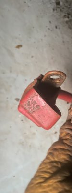

Still no luck finding the source. Added some pictures of the fuse. I peeled back the wire loom on the alternator wires and they aren’t crispy which surprised me. The loom is melted in a few spots on the outside I’m guessing from the engine. 1AF6A616-6D91-4E88-9F13-2D368ABCA6F2.jpegA601126C-0A60-4E56-97CA-79D08E71105A.jpeg

It looks like both the ALT feed and motor feed are melted? If that's the case then it shouldn't happen unless the battery cable was installed to bypass the fuse

When I took it off it had the big battery cable coming off the perko going onto the starter motor and the fuse, and then the other side of the fuse had the orange ALT wire and the smaller red wire coming off. Yellow/red going to slave was attached to smaller bolt on the starter. I think that’s how it’s supposed to be? At this point I’m thinking I will check and clean my grounds and then reloom the alternator run and make sure it’s clear of the engine and then cross my fingers that it’s fixed. C92784EC-7942-43EC-A83C-6FDC876742FF.jpeg

Yeah that's correct. What did the wire on the other side of the fuse look like? It looks like your current came from the alt going backwards.

Its wired correctly but there must not have been a fuse inside the fuse holder

IDK, I would have expected the starter side to be melted as well. Wondering if full fat battery power from the trim circuit found its way back to the alt. Although it still should have made it back to the 50a breaker as well I think.
