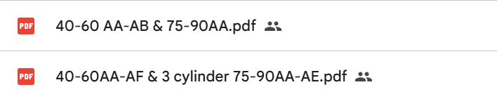

download one or both these manual check your PM and if you plan servicing this wonderfull engine you get the EV diagnostic software to know exactly how your EMM is doing or not doing. my 2005 75hp has been near flawless in 20 years but... i pamper it
you should visit/consult te ETEC OWNERS site where ETEC owners from around the world share their experience. SIte offers a good SEARCH facilty on problems and cures.
