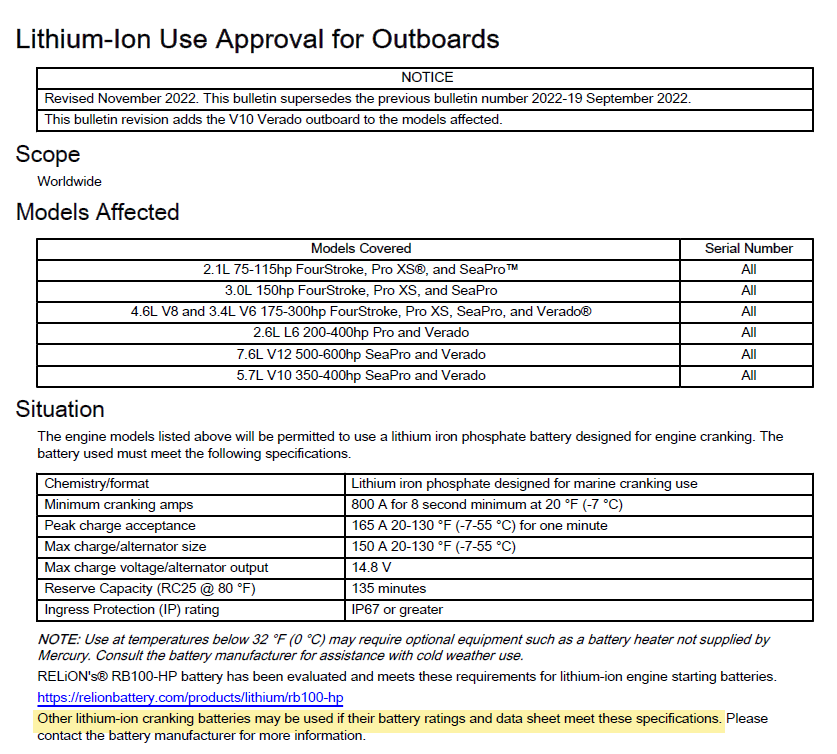

Mercury Marine has issued a service bulletin that approves a number of their models for use with lithium starting/dual purpose batteries where the alternator of the motor does all of the charging.
I suppose that on the basis that Mercury says it is OK, many Yamaha, Suzuki, Honda and Evinrude owner's are doing likewise to no ill effect. The need for motor maker approval not being needed.
Many of the lithium battery suppliers state their batteries are suitable for use with outboard motor alternators.
The "Only" LIFEPO4 Bat approved for starting by Mercury Marine for there OB's are made by Relion
Bulletin
Bulletin
Negative.
Mercury Marine approves the use of any lithium battery that meets the specifications set for in the service bulletin. A battery by Relion happens to meet the specification.
