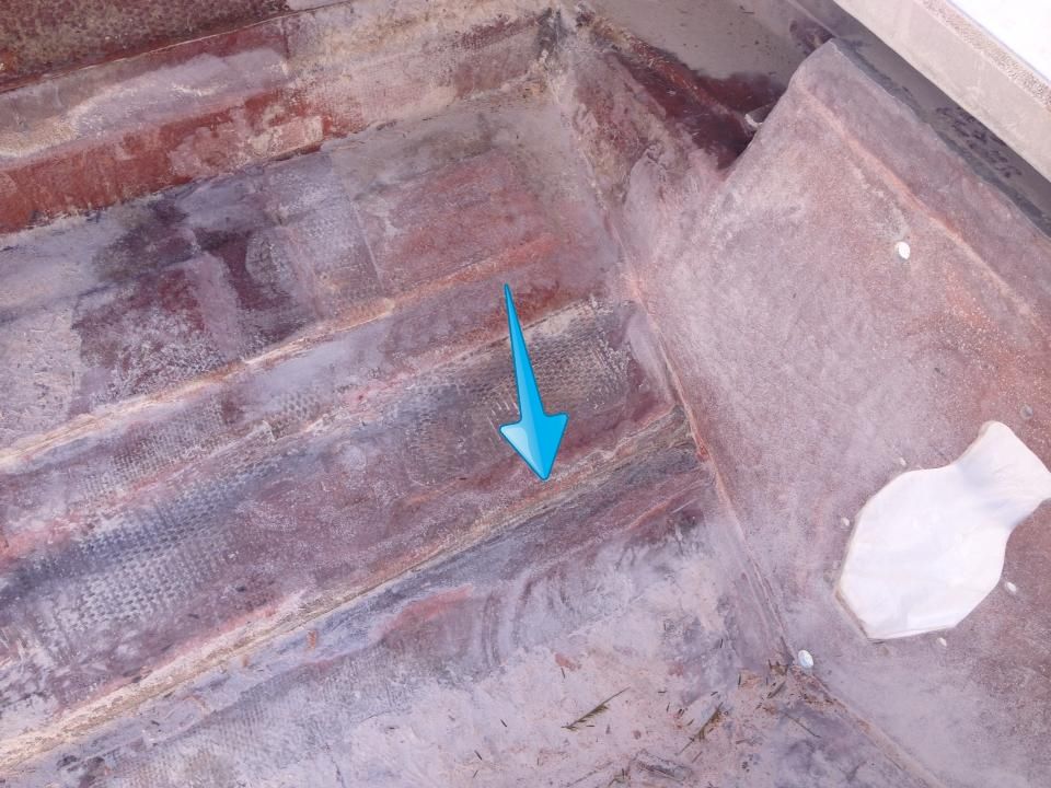

"Houston We Have A Problem" I had a mishap with the grinder-operator error. How should I fix this? Pix below. I think that is a streak below the hole

That wood looks rotten anyways. I have exact same design in my boat and all of the wood was water logged, so i removed. looked like a 2''x2'' cut at a 45 degree angle. I'm just going to put a stringer in its place on both sides. picture shown after removal (went from bow to stern and were 6 inch segments of wood)

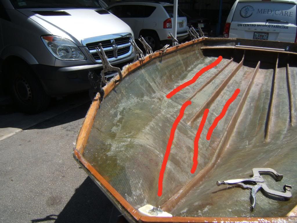

The outermost strakes on my tub were made that way, seems like a strip of plywood, not very big dimensionally, was laid in the strakes and then covered over with cloth and resin...of course, they became hollow over the years as the wood rotted away...
In my case, I just ground away the upper layer of glass, re-filled the strakes with thick PB flush to level of the hull, and layered on new 1708 biaxial cloth...right or wrong, overkill or not, it "felt right"...:rolleyes:...BTW, I only ended up doing that to the outermost strakes, and partially to the next couple of inner strakes, but only until they joined up with the newly installed stringers that took care of filling all but those sections...
Here you can see more or less what I am talking about...
Where the red lines are, that's where I did the PB filler, same on the other side...
You might be able to get away with just leaving them hollow as they are and just make a simple repair over the hole...

OH NO!!! The boat is TOTALLY Ruined!!! I'll have to come haul it off for you. Won't charge you a dime!!!:joyous:
Seriously, You are NOW officially a Boat Restorer!!! Kinda like getting Blood on your face when you kill your first Deer!!! Mix up some PB, fill it Lay some 1708 over it and "FUHGITABOUTIT"
