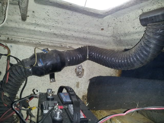

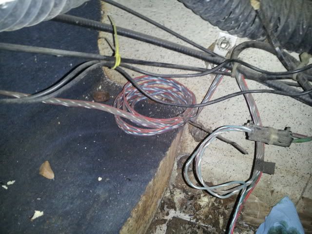

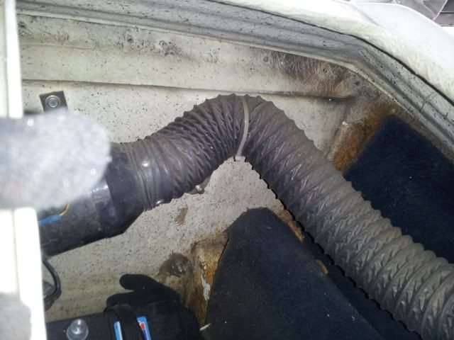

I believe my transom spans the entire rear, with a doubled up center section.
Which stinks because I'll need to remove part of this shelf. It runs right above the floor line to about where the shifter is. It is made of foam glassed over. I'll have to cut back enough to allow me to tab the transom and have room to clean the old glass.
