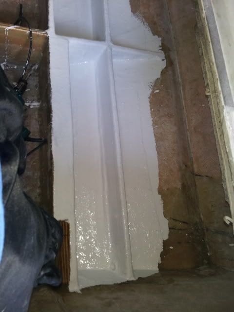

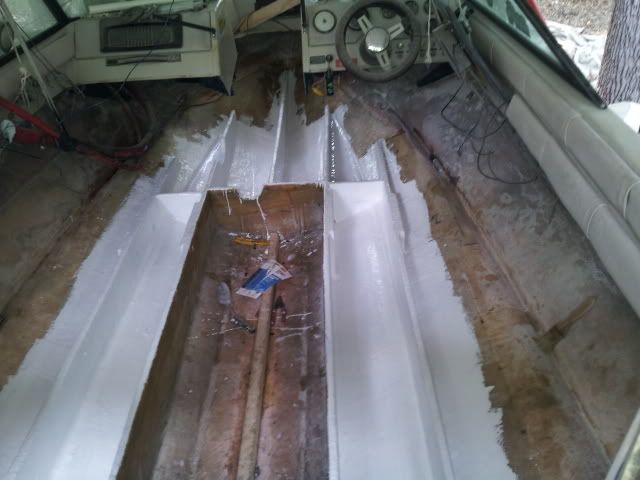

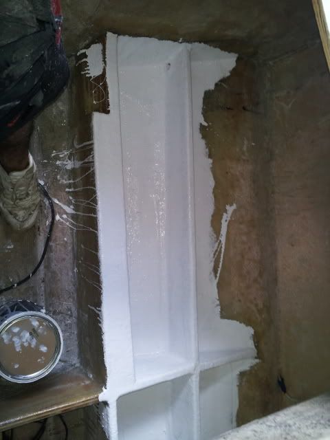

For once I got everything accomplished in a day I set out to! I got all my stringers capped, and man does it look good for those things to be completely glassed over.
Now I have to
-do a little cleaning with a grinder then paint my stringers
-glass in the 2x2 in the bottom center of my tank section
-seal and install 2x2 ledgers
-build up and fair my transom
-install my tank
Then I think I'm ready to cut deck templates and start on that!
Still lots of work to be done.

Got my first coat of paint on my stringers today. Probably unneeded, but it didn't cost a great deal of time or money. Also have my 2x2 ledgers cut to fit and sealed with 4 coats of spar urethane. I guess my next step is to finish designing whatever I do to mount my tank, finish glassijg that 2x2 you see in the center of the boat, then start cutting templates and a deck. I don't want to put the tank in until I am done glassing and painting the deck because I don't wanna step all over it. I'll run my hoses and wires andtest fit it, then leave it out till last.
