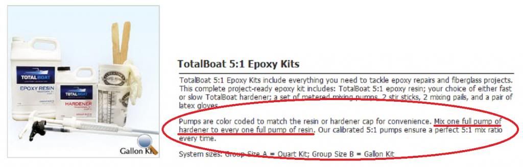

From the Total boat product description:
Pumps are color coded to match the resin or hardener cap for convenience. Mix one full pump of hardener to every one full pump of resin. Our calibrated 5:1 pumps ensure a perfect 5:1 mix ratio every time.
I know the instructions are just the manufacturers opinion... but sometimes it really pays to read them.

Re: Didnt get Hard? Jamestown Total Boat.
View attachment 217288 Negative, I used the same 5:1last month when I laid a bunch Of Fiberglass, No problems what so ever.
So 2 wrongs make a right eh?
I agree with WOG, even if your first batch did get hard, I wouldn't trust it... read your instructions and mix up a batch according to the manufacturers opinion and see how well it works, you may be pleasantly surprised.
