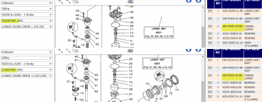

You might want to withdraw your comments about there being no standard or counter rotating lower unit on a Yamaha.

L200 is the model that would have come with a counter rotating gear case installed. Only difference between the two models. Keep in mind that whatever is on there is anyone's guess. Some folks convert a counter to a regular and a regular to a counter simply by swapping the gear case.

standard and reverse are two different systems ,same with the cases
Not so in all models. Here is an example where the same gear case casing is used for both the regular rotation model and the counter rotation mode. Only some internal parts are different.
