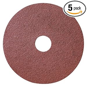

You're gunna find these will be your best friends. 4 1/2 inch Dewalt angle grinder (Under $50)
Rubber Backup Pad, and 34 Grit sanding discs. Dont use the Flap Discs. The sanding pads work WAY BETTER!!!!
