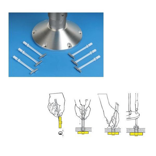

other people have used toggle bolts on some decks. there are stainless toggle bolts that have the little plastic retainers to hold the threaded portion under the deck while the epoxy/methacrylate/resin cures.
below is from mcmaster carr which is half of what the marine shops sell it for (because they get them from mcmaster carr)
